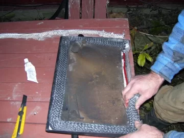

I could be wrong, but I am thinking that the old, old BK had a steel door with a large size gasket attached to it. However, there wasn't a channel for the gasket to set in, nor one on the face of the stove. The gasket was the seal, basically steel against steel with thick gasket as a seal. If the BK is the stove I am recalling when the gasket compressed with use, the seal was rather hap hazard at best.
With attached Pic. This is what you had to do with those old boys every couple of years. They could still snuff a fire out at ten paces. A true smoke dragon though. The door on my new stove has a well refined and a real simple/ easy to adjust mechanical advantage door latch system.
