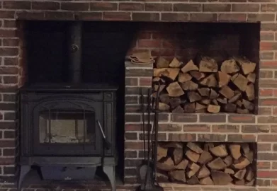

My 1400C:
[Hearth.com] Does anyone have a Napoleon 1400 freestanding?
Wow, Principal! That is one neat and tidy stove area. I'm jealous.
