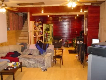

hey nice remodel job on the house I like your Craftsman compouns miter saw Does it tilt to both sides is it laser? Also nice dog and I like your man made pond
I made my own platform extention. I have a Makita LS1212 12" dual direction compound slide miter. Is that t&g 6" pine on your walls?
yes it tilts to either side and it's laser guided.It's tongue and groove center bead board..the whole house is a work in progress.tomorrow installing more insulation in the attic.beleive it or not that pond holds just over 700 gallons of water..are female is expecting puppies..Just what i needed more dogs....lol..But it's all good
