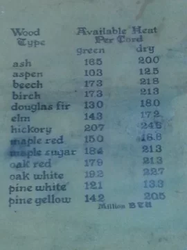

Does this look accurate?
mass_burner
Sep 24, 2013
2,645
SE Mass
Found this in my basement when I moved in. It's cavass material.
  • [Hearth.com] Does this look accurate?
That yellow pine must be really good stuff. It's right up there with oak, beech, hard maple.
All the charts I have seen have slightly different numbers. That's the first te I have seen yellow pine up near the top though.
The birch, aspen and fir are roughly in line with what Im used to seeing, the rest I dont pay attention to since we dont have them here.
