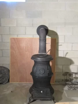

I got myself a new (and better) damper. This one doesn't leave very much clearance between itself and the inner wall of the flue so I can really control the draft now. I think my problem before was that the old damper was letting too much air through; consequently, the belly of the stove was over heating. I figured that out after I called US Stove company a few times. By the way, are they a decent company? Do they make decent products? I am thinking about upgrading to a better stove but only if I could determine if the one I have is a bad quality stove....
I also bought some Rutland stove polish and shined up the old girl real nice--you can see how pretty she looks now. I was thinking about putting some red lipstick on her so I could say I had just put lipstick on a (pot belly) pig....
I'm hesitant to light her up she looks so good....oh well....Thanks again for your advice on this project!

Sure does look better. It's surprising what a little makeup will do.
