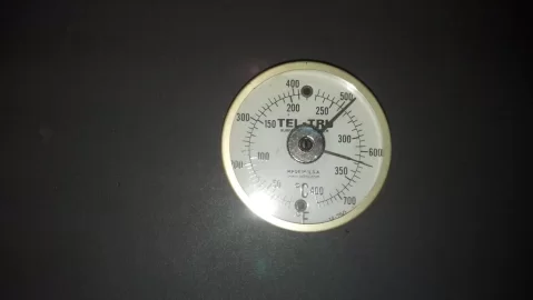

    That pic is a link to the product - they make lots of them still.
    DD... is that one like the one I linked that you just set it on something (like the grill grate) or is it attached some other way?
    I have no problems trying out the Condar except the price... that one looks like it would be about $21 or so shipped. The one I linked you could get 3 for nearly the same price.
  8. DexterDay
    DexterDay
    Guest 2.
    Its magnetic. Just like most other stove top thermo's.

    DD What is the model # of the magnetic Tel-Tru? I looked on their site and only saw ones with probes.

    $47 ouch.
    Well I couldnt really find any other 'stove top thermo's' but the grill surface thermos I dont think are magnetic. But they are <$10 for example http://www.amazon.com/s/ref=nb_sb_noss?url=search-alias%3Dlawngarden&field-keywords=grill+surface+thermometer which is fine for my intended use on the stove top of my old stove, but without the magnet it would have to lay flat on the top. I just wonder if those are as accurate without having a better 'connection' to the surface. I might just order one on my next amazon order and compare it to my IR.

    With the one Min/Max needle (option) it was $65.07 plus shipping!!!
    But, it is dead accurate and even holds up pretty good in front of the blower.
