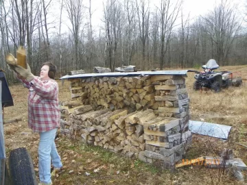

Here is a picture of a neighbor loading some wood from one of our stacks. Notice the galvanized roofing we use for covering. It works great. To hold it down we just throw some of the uglies on top. We have also screwed it down into the wood which helps too. Still every so often we might get one that blows off in a windstorm but that is easy to take care of.
