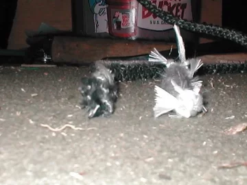

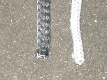

I did notice the gasket sent to me is lighter and round. The one I pulled off the Summit is heavier, appears to graphite impregnated, much denser and tighter and flat tape like gasket. I will head down the hardware store tomorrow and see if they have the Rutland grapho-glas one. It looks exactly like what I pulled out. I thing I'll try the 3/4" one instead of the 5/8". The original barely had a knife edge mark in some parts of it, while the other areas had a nice edge showing where the seal was being made.
Heres a couple photos showing the old vs. new. The old one is flat as opposed to round. I have seen them called tape gaskets. Rutlands is pre adhesived, just pull off the paper tape and stick on. Tempting to try.

Looks like PE uses hi-density gasket like ESW does hog. Hard stuff to find. The regular gasket is the soft fluffy stuff and it is what most stove stores carry. Last year when Lowes was shucking stove stuff like a dog with flees I noticed that they had the Imperial 5/8" high density and were getting rid of it for three bucks a pop. I bought the last three kits they had.
I think your right. The original is very heavy, dense & tightly wound. The one I got from Tom is light and no offense to him, but seams very flimsy.
Its definitely a tape gasket (flatter & wider). Is the stuff you saw & bought at lows round or tape?

Im telling ya bro, this is a tape gasket. Ain't no way it got perfectly flat all the way around. And there is only the knife edge on one side, nothing to compress it like that perfectly flat. I am going to call PE tomorrow and ask them. I hope to do this only 1 more time this year ;)
The rutland grapho tape gasket is 3.65 lbs. The white stuff I got is not even a pound I bet for the entire length.

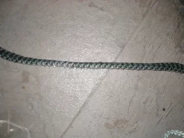

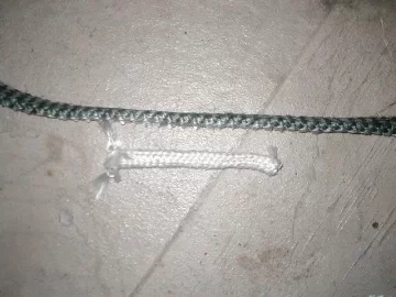

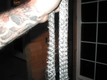

2 more photos.

Even Imperial has tape gasket, mine looks just like this. Ah hell I'll let PE tell me whats what.

I ain't pulling nuttin out, cept the cement off the door. The tape gaskets I been seeing are very thin, 1/4" so you may be right bro.
I still say mines a flat tape gasket but thicker. PE best have some answers.
