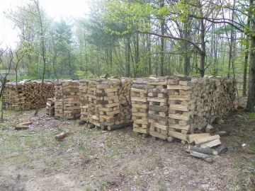

We've stacked single rows, double rows, triple rows and once I think we had about 20 rows together. All the wood has dried very well. It has been pointed out to me by many that only the outside rows will dry. However, if we look at that closest stack of 3 rows. they were stacked in April, 2009. They were all stacked the same height. That stack on the far right and the one right next to it are still there. It is funny that they were stacked tight together and we sort of kept track of the height of the stacks. For example, we stacked the wood 4 1/2' high. Within a year it was only 4' high. It has shrunk some since and all the rows have shrunk the same. So, if those middle rows did not dry, how would we explain that they are the same height? As for how they burn, we've never had a problem and I'll assure you these will burn wonderfully when we finally get around to burning it. Probably will burn some of it next winter and the remainder the following winter.
