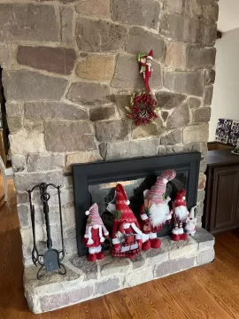

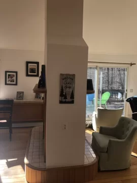

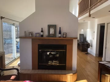

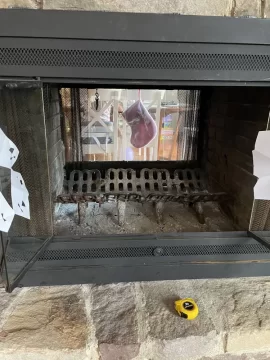

The dreaded double sided wood fireplace!
I know this has been posted before but I really don’t see a great option for my dilemma.
I am looking for all options for an efficient way to heat and utilize the current fireplace space I have. But also doesn’t cost the same as a new truck.
The openings on both sides measure
H 33” x W 35” x D 39”
Thank you in advance for looking or steering me in a direction.

As you've discovered, double-sided fireplaces make great wood-powered air conditioners and smoke machines. Our solution, which is working very well, is an insert in the side where we want the most heat (see my icon) and regular glass doors on the other side, which we can open/close depending on how much heat we want off the back of the stove to circulate in the dining room.

The standard recommendation for these has been to close off one side with something decorative, and place an insert into the remaining side. That decorative block-off could be an old stove plate, fireplace backer plate, sheet metal painted black or with a pretty winter scene.

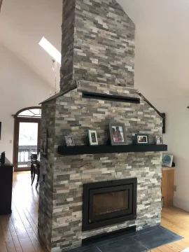

Yes, the glass doors on the dining room side hide the somewhat ugly back of the stove. Even when they are open for heat, the chain link spark curtain lets air through but pretty much hides the sheet metal back panel of the stove, as the pix I linked to above show. The insert fits most of the way into the living room side in our house and it looks fine on that side.

Hey, if you have glass doors on the un-used side, you could probably just slip black painted sheet metal behind them, to hide the back side of the insert, and leave the glass doors. But I'd clear that plan with a pro (like @bholler), to be sure it's kosher. Also, you will need to be sure your fireplace doesn't preclude use of an insert.

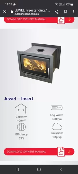

Ideally I would like a see through fireplace that does an ok job of heating the house if it had to in an emergency. The Astra duet is 100k BTU rated and I am lead to believe that so is the Ambiance 42ST. The RSF Focus ST has a bigger firebox but rated 50k btu maximum.
I found this site and signed up to get some thoughts on:
Can I achieve my goal with a see through fireplace? Reasonable heat once in a while, not heating the whole house full time with wood.
Why is the RSF rated so much differently than the Supreme options because the Focus has a nice thick 1/4" plate door and I like that versus the stamped steel of the Ambiance.
The Ambiance Elegance tested at around 25K btus in EPA testing. The 100K sounds like marketing. The RSF appears to be more conservatively rated. As noted earlier, double-sided fireplaces are not as efficient. It is very hard to achieve secondary combustion in them.
