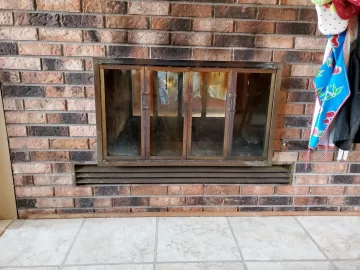

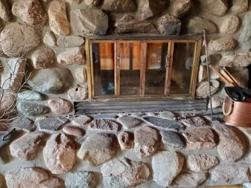

Dan, would you have a picture of the back side of your insert? We're getting a bid on a wood burning insert for our double sided fireplace, the side opening into the kitchen/dining room would be the backside. One place we talked to typically fastens a black metal rectangular piece. We'd like to explore our options, ideally something more aesthetic. The present glass doors reflect the 70s build. I'll try to post a picture.
suzy in Minnesota
Oct 22, 2022
3
Minnesota
Here're both sides, looking for ideas on covering or utilizing the brick/kitchen side of this fireplace once we get a wood burning insert on the stone side/living room.

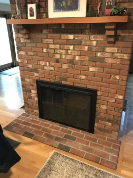

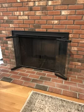

Here are pix from the dining room side, with doors closed, and open, so you can see that the back of the insert is fairly well concealed. The installer offered to paint the sheet metal back of the stove, but we decided it doesn't need it.

Thank you! That looks very nice! Your black surround and door trim looks sharp! If we end up keeping our doors, I would check into having ours painted black. I've been googling 'fireplace covers' and 'options for non-working fireplaces' and am finding some options.
