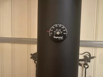

So, I might have gone with beauty over brains. My thermometer came in the mail today. I put it in and couldn’t get over 175-200 in the stack with sst ranging from 300-400 during the day. I took the magnet off from how it came from the package, and flipped it over. This let the coil go, and wasn’t being pulled tight to the magnet and binding.

Now I’m 500-600 SST tonight, and I seem to be hanging around 250-300 in the pipe. I did hit 400 for a minute, but it didn’t last long. SST is hotter than the gasses????

Right now I have a coaling log that just crumbled into 3 pieces, SST of 425, and flue reading of about 150+\-
I've got the same probe, it took me buying an Amprobe Multimeter with K-Type thermocouple to realize mine read about 150f low. Loosened the nut and adjusted the setpoint and now mine reads much closer.

I actually bought two. I just switched them out, but it may be too late in the fire to tell if it’s settled in anywhere. I mean, the stoves gonna be hot for a while, but it’s steady dropping at the same time.
This is what I reversed earlier. Now the magnet is stronger on the stove pipe side and doesn’t bind the spring. Both thermometers came with the strong side facing the spring though. Is that part of the calibration method and I’m screwing that up. I can’t imagine it is, but????

Either way, it still seems low.
Can I calibrate it with boiling water and keep adjusting it till I get close to 212?
That didn’t work.
I tried it in the oven too and it shot to 650. Now that I think about it, that might have been as the burner was on during preheat and it was trying to get that cold sucker up to temp.
