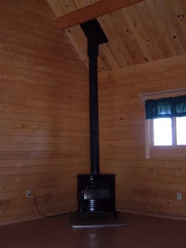

This is my Shelburne, straight up and out, 800 sf cabin, single-wall flue up to double-wall chimney. I understand your desire for closer clearances, but as far as heat goes, it's easier to open windows and cool off the house than to make it warmer.

Very nice set up. How close are you to the walls? Mine is right next to drywall. A large amount of the heat is coming from the stove anyway. I'm just not much of a gambler.
I have the rear heat shield, so the corners of the stove are exactly the minimum distance to the solid-wood walls (I don't have my manual with me, but it specifies how close you can get with single-wall pipe and a heat shield). I've measured the temperatures on the surface of the walls with my infrared thermometer and they haven't ever gotten hot. Just make sure you use the right distances for your setup and you'll be fine.
P.S. The photo was taken the day the stove was installed, before I got furniture. Looks a lot more homey now...
