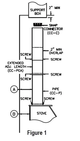

Did you get a name of the tech saying that? I would contact Mike Holton at Englander tech support. Sounds like there is some bad information going out here. You are doing it correctly. As for the screws, this is from the 17-VL manual:
• Use three sheet metal screws at each single wall chimney connector joint (check manufacturer’s
recommendations when double wall chimney connector is used).
• Drill three holes in the flue collar of the unit and attach the chimney connector to the unit using sheet metal
screws.
And this illustration is from the Duravent DVL installation guide.
Joecool, listen to BeGreen.....I haven't been on this site long but I can tell already he knows his stuff, and he included the illustration to back it.....make sure you follow the instructions, you def. want to screw that down....and I would definately call the Tech Support like he told you, someone is gonna get their house burnt down or worse with bad information like that goin around....
Thanks BeGreen, I had read that in the manual but wasn't sure if it applied to the DVL pipe. I'm definitely going to screw it down. The only question now is do I put in any screws at the TOP of the DVL pipe going to the adapter up there? It's a snap in connector so it's in pretty good. The Duravent support line said that it wasn't necessary, but I don't mind "over-doing" it. What do you guys think?
