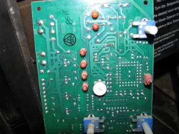

Should I decrease the exaust fan? According to what I searched here I can only get a ten percent adjustment of draft motor.
