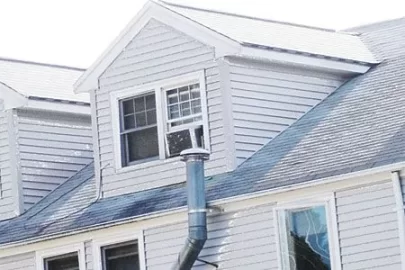

[Hearth.com] Draft
These guys are getting close to having it figures out!
Can someone explain to my wife that not crazy and this needs to be done.
