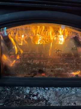

I’ve recently bought kiln dried wood (2 cords) from a family owned farm. It burns nice when conditions are right (gonna see if my cap is causing draft issues soon) and while the outside is 4-13% moisture, the inside on a lot of pieces are 22-28%. Anyone else have this issue with kiln dried wood?
I thought it was just bad luck, so I bought a bag of kiln dried wood from a reputable dealer who sells bags in store. Tested the outside of a large split - 3-5%. Inside, 28%. What’s up with that? Though again, When conditions are perfect, they still burn nice.

Kiln dried is more for killing surface bugs under the bark than drying it seems when it comes to firewood. To split wood and throw it in a kiln for such a short amount of time considering the split size just can’t physically dry it out in time to be profitable for the companies. 1x trim boards etc at your lumber yard are a lot thinner and dry quicker but wood that’s 5”+ thick would take a while.

do you have a wood rack near your stove so the wood can sit in the same room as the stove and dry out? I really don't know anything about kiln dried wood. I've never used it, but my guess is they either didn't kiln dry it completely or they stored it improperly. Those are just my thoughts.
I wouldn't burn anything higher than 20% as you're going to guck up your stove and chimney with creosote and cause more problems than you need.

Kiln dry is just to kill bugs as said above. Inside won't be dry unless it is seasoned long enough.
Burning in an open fireplace is where you can get away with burning the wetter wood and why the sellers can get away with saying it's ready to burn. It's still going to cause creosote in the chimney but they are long gone by then.
Buy any wood very early and stack it to dry as soon as you get it. Then you will have control of properly seasoning it.
