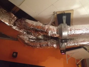

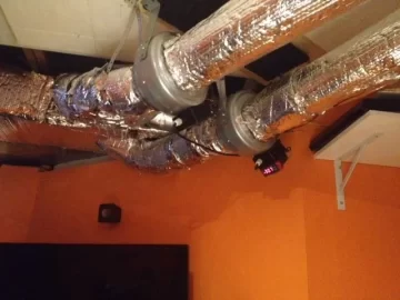

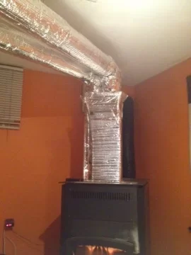

i changed my WRT TO 110 F and CLDT to 99 f and no more error code on ignition of pellet smoke after shot off .
i use 2 inline fans to supply air to original hvac ducking and supply all house ( twin turbo.... )
Thank-you
fan operation :on Thermostat demand if duct temp= 21 c ( thermostat 1 duct senor ) and eco65 exhaust temp= 26 celius.

Wow, that looks like some crazy ducting, are you using china ebay controllers for duct temp?
