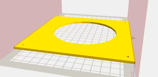

The 4" diameter pipe is inserted through the wall, but the interior hole in the drywall will look rough if I leave it that way, so I make a square or round cover (maybe not the right word) with a 4" hole in white PLA to make it look nice. It's very easy to design in Tinkercad now that I got the hang of it, then I download the model and print it, sand it a bit to make it look pro and install it with some screws. Easy-peasy.
This is what I mean. Took me about 15 minutes to prepare, I just need to make the size a tiny bit smaller to fit my printer. Anyone can download and use them as they wish here: https://www.tinkercad.com/things/ivvv2kbuu4U
