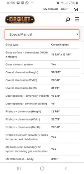

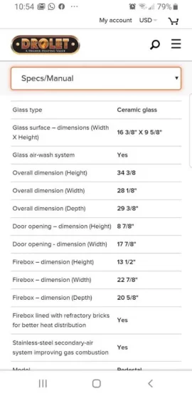

On the drolet site it shows the 2000 is cosmetically different shows the 2000 has more cubic ft in the firebox but the glass and door opening is bigger..the first photo is the 3000 and the second is the 2000

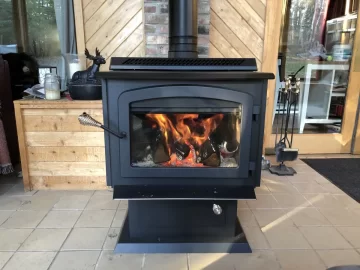

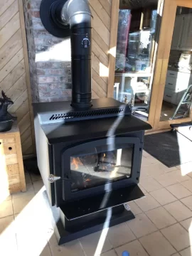

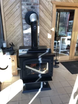

We will see how she goes brand new HT 3000 install. Can still smell paint. Vented into a 8” Class A chimney which is a no, no!

Good looker. It's not ideal to go up to 8" but not a complete no-no as long as draft is sufficient. Flue gases may cool a bit more so keep an eye on the chimney liner and clean more frequently to determine interval.
Reactions: UrbanBrnr
It is often specifically allowed in the manual to vent a 6” stove into an 8” chimney. No, not ideal, but totally allowed if the manual says you can.
Manual said as much as 7”. Drolet tech support said we’ll have trouble. So far the only thing I noticed is I have slightly less than ideal wood for it compared to my old Frontenac stove.
You're right. Equally surprising is that they say it can be connected to a 5" flue in Canada only. Clean frequently, especially with sub-par firewood.

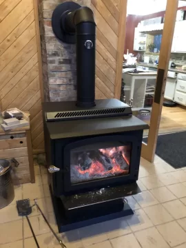

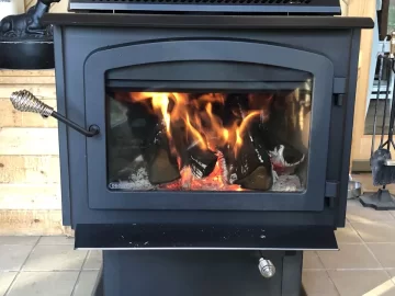

Somewhat of a newbie with the EPA style stove so forgive me. I bought this from efireplacestore.com for $1,222 to my door. It’s extremely well insulated and holds heat for a long time. I would imagine that might be the only real difference from the HT 2000, which others have commented on earlier in the thread. It has a solid ceramic baffle from the back all the way to the front, also side shielding has been beefed up.

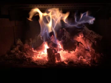

I’m heating an older single level ranch style house @ 1,350 sq.ft. In Northern, MN. It’s been the wettest on record on here so I’ve been burning at about ~25% moisture content and as long as I have a hot fire or good bed of coals no issues. I do have this stove vented in a 8” by 15’ long duravent rigid double insulated chimney liner. I installed the liner last year after my chimney didn’t pass inspection and wanted to use it with pre-epa wood stove. Well that stove drove me insane filling it all the time. I couldn’t justify spending the money to go to 6” liner this year.
Thus far I can’t tell if the larger chimney affects the stove performance or secondary burn cycle. It produces lots of ash and coals, something I’m not use to is how clean burning the exhaust is. Definitely helps cleaning every other day. It’s still shoulder season so I’ve been putting in smaller 1/4 splits and I can get 5 hrs I’d burn time no issues. If I push it any farther I have to open all the windows in the house. Primary air is on the bottom on this one. I don’t back it down till it’s good and hot. To early and you lose the secondary burn. Still educating my self on proper techniques before bed and during the work week when I’m gone for 5hrs at a time. So far nothing but positive, looking like I might use half the wood but a little to early to tell. Here are 4 smaller logs I through in at 6pm with the intake 1/4 open and I won’t address this for another couple hrs. Pretty small stuff I’m heating with now if you can tell by the pics. Only 40 degrees out as of lately with colder weather on the way.
Don’t know if this helps answer any of your questions. I spent a lot of time on this forum justifying this stove vs a Englander NC30 and since the new EPA stuff is out, thought I’d take a leap of faith on a new model. So far no regrets...

Thanks for taking time to post a review , it sounds like it’s going to be a great stove so far. In the one pic it looks like it has burn tubes unless it’s just the angle? Did it ship completely assembled or did you have to attach the pedestal base ?
Yes everything came assembled. Stainless burn tubes and all.
wow it's beautiful...and thanks for sharing all the info and the pics...I just got my HT2000 but really like this stove even more. If I had a way to swop it, I would. The clearance is much more refined which is what I needed. Please keep sharing, This stove will as popular as the HT2000 over time.
