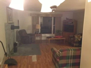

This is a couple of pics of my house.

Thanks again for all the replies. I went from a fireplace insert( closed off now in the pic) and bought a Timberwolf that was rated for 3500 sq feet. Too big for my place. I get a little bit impulsive when it comes to wood and wood stoves. I'm sure you all understand. ;)
Nice room, I would consider a next size up stove, something like a 2cu ft box.

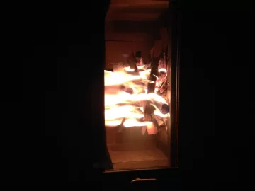

first fire
  • [Hearth.com] Drolet Jurassien
I've learned a couple of things about the new Drolet Jurassien. The casting is made in France and the same design is used as a coal stove in Europe. There is a large removable top piece of cast iron, but this serves no purpose on the wood burning stove, as the coal stove loads from the top, so Drolet just left it as is.
I am really interested how this stove proforms for you, I love the looks and since I maybe in the market for a 2nd stove due to an addition next year, this might make the list.
Awesome stove with the sideways flames. How do you keep the wood up there? Does Drolet provide some special firewood glue? ;lol
