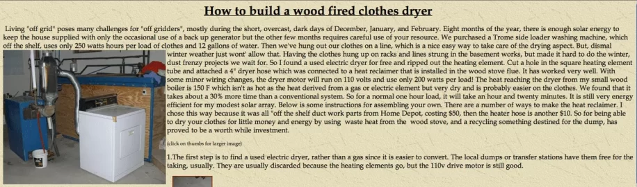

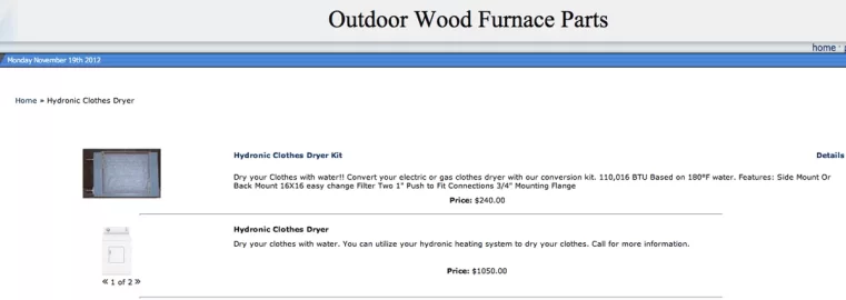

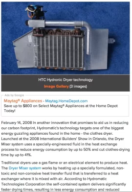

    SW Missouri
    There are some conversion kits, some hydronic clothes dryers and plenty of DIY examples out there.
    shmodaddy likes this.

    Thats pretty cool Bob. Or should I say thats pretty hot.
    Now I have another squirrel to chase. Thanks.
