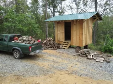

Here is my high-tech woodshed. It looks tiny but it holds a lot of wood. It holds 9 Nissan pickup loads of wood, more than a one year supply, and I burn a lot of wood. Not only do I have a Jotul F500, but also have a nice wood burning fireplace that we burn quite a bit.

Before I built my woodshed I researched various types of wood drying on the woodshed forum. I didn't see anybody who had built a woodshed like the type I wanted to build.
So, in the interests of science, I went ahead and built my little shed.
I am open minded, I have a moisture meter. I believe that heat will dry wood better than ventilation. The key thing is to have unpainted wood walls and floors. As the walls and floor dry out, the water vapor from the wood will go through the walls and floor. In theory.
I will report here at Thanksgiving and give the results of my "high tech" solar powered woodshed.
If it doesn't work it would be a simple matter to ventilate the shed. Take out the fiberglass insulation that I blocked the ridge vent with, cut holes in the sides and install 1/4 inch mesh hardware cloth, and open the door.

Heat will indeed dry wood faster, if you can keep the RH% within the shed at a reasonable level. Unfortunately, without ventilation and drainage, you're likely going to have trouble doing that. This is why homebuilt solar kilns always balance ventilation against solar heating. I foresee moldy wood in your future, unless you provide some ventilation.
