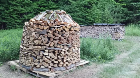

Holz Hausen complete finally!

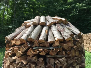

My wife told me that I need to increase the number of top pieces to create more of an overlap to the ends. do you guys agree?
Yes, I would do another layer of wood split shingles, try to get them almost to the edge and layer them like shingles or close to end to end as possible, trying to create a path for water to drip off the pile. But all in all that looks really good, I'm thinking that that's how I'm going to stack wood from now on by me, I can stack the same amount of wood just with a smaller foot print using this method.

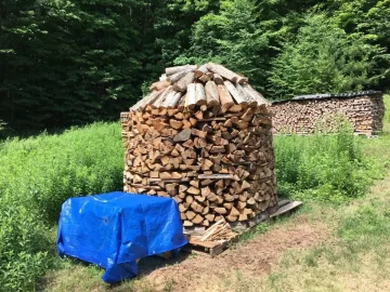

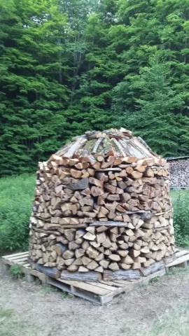

Holz Hausen with Black Birch and Hop Hornbeam shingles applied as close to edges as possible. Now...finally done. Couldn't get anymore wood on their even if I wanted to.

hi ken
on your bottom row the splits are making the circle. are they like that thru to the center or just the edge so the splits pitch down towards the center?

I was thinking of making a cheap wood frame using 1x3's kind of like an umbrella frame and cover the top for the winter. I'm just trying to figure out how to proportionally make the frame and allow it to sit 6-8" above the wood to allow air circulation so I don't have condensation issues with the tarp directly on the wood. Already figured how to anchor it, just tie rope from the frame to splits on the bottom.
Just the edge so that the first row circle pitches down.
I'll post pics when I get to that project, others might build off of that idea and make it better
For the winter I was planning on simply putting a tarp over top although now that I think about it putting actual shingles over top section could actually work. Not too worried about condensation with it being winter and all.
is there a reason for tipping the splits in? for keeping it together? what about water running to the middle?
That is the typical way a Holz Hausen is constructed I believe. The idea is for the outside splits to slightly tilt in to start then as you build up there is a slight pitch of the entire HH inward (basically like a very gradual cone). In this manner as you add your splits to the middle, the external splits 'per se' lean inward and are supported against the internal splits for support. If you think about it if you didn't do this as the HH got taller and it leaned out it would have much more of a tendency to collapse with the internal splits applying forces outward. Seems to be very stable when constructed in the manner suggested. If you go to you tube there are a number of time lapse videos showing others constructing these and this seems to be the preferred and most practical manner as I suggested above. With regard to water dripping inward I assume this happens to some degree but if shingle pieces are done correctly then most of the water should shed off sides and of course some will drip back in but I would think this would be minimal. No expert here but seems to be doing well for me. Rained all day Sunday and when I went out Monday the stack was dry in no time with the sun back out. Like I said in earlier post, I would cover in the winter so snow and snow melt doesn't accumulate across the top but while seasoning during the summer I think a good amount of the water will shed. Good luck.

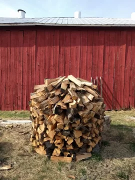

I may have to cross-post to other similar threads once I build more, but I'll hang tight here since this is indeed my very first holz hausen / holzhausen / round stack / Norwegian beehive. I considered it "done" as it's a little taller than 6 feet at this point. A tad rustic, but I bet #2 will be snazzier.
Overall verdict: sure was fun to build. I'm sure I'll get a better hang of it once I make a few more, and adapt a more refined look. I'll give you all a holler if anything exciting happens and/or when #2 is done.
