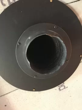

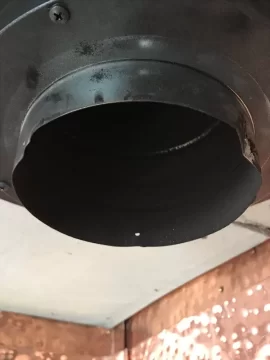

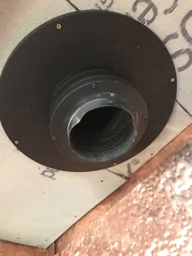

So today i took my dvl off the stove and cleaned with a soot eater from the bottom up i was suprised to see the dvl adapter pushed in and dented where the installer tried to install self tapping screws? Im not sure if this was the correct way to connect the dvl but i assume the dented sections helped make those high readings as it was barely acting as a single wall pipe and they were the exact spots it was reading the hottest if you remember me saying the right side was so much hotter than the left. How do you guys suppose i go about fixing this? I think i should bend them straight and predrill where the self tapper was hitting then install the dvl so thr screws suck it tight together. Honestly i dont know why he even put the screws in the screws in the telescoping section would have held it tight? Any suggestions does it look like it was done correctly? And should the dvl have holes through it from the self tappers? Here are some pictures

Have seen this before, especially with double-wall pipe. The adapter collar is thin metal. Once the pipe is up and in place, I like to pre-drill a small pilot hole that allows the screw to get started and attach to the ring.

Thanks again for the quick reply im burning oil waiting to put it back together and not happy about it!!!! Cleaning went great it was very clean considering the crappy wood i burned in the beginning. I will feel much more comfortable turning it down sooner now. The soot eater saved me from going on my steep roof in the snow although in the spring i will go up and inspect but its a great mid season cleaning tool. Btw it seems to be a better deal just to buy a whole second soot eater if you need extra rods than to buy the rods alone. So i assume your suggestion is to do as i said straighten it out as best i can and look at where the self tappers were trying to drill and put a piliot hole in and let the screw suck it straight?
Yes, straighten out the adapter collar. Install the stove pipe. Then take a drill and using a sharp drill bit make a tap hole in the collar. Use a black panhead sheet metal screw to attach to the adapter.

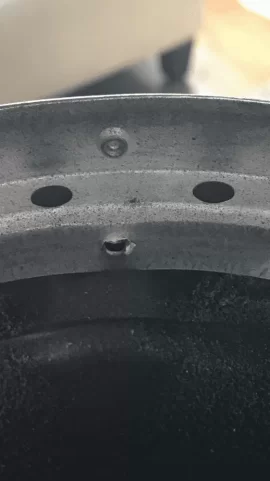

sorry to bring an old thread back to life. I'm not sure if you guys remember me complaining of the extremely hot temps at my ceiling support box as shown from my IR thermometer in the pictures above. Today i took my chimney apart to clean it and i was thinking about those high temps. I decided to take my connector off to the ceiling support box and couldnt help staring at it and just thinking something doesn't make sense, why would the little holes at the top of the dual wall pipe be blocked by the trim kit? So after looking at it scratching my head I went online and saw the connector from the dvl to the ceiling support box looked different. i went back to my bill from the supplier and they gave me a 6dvl-adc which looks like it can be used with either durablack or dvl so i guess technically it is the right part, but the 6dvl-adt adapter seems like its specifically made for the dvl chimney and is not a one size fits all in addition those little holes between the inner and outer pipe continue. Does anyone think that switching the the dvl adt would provide a better connection and keep the support box temps down?
