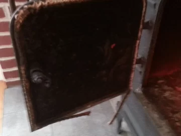

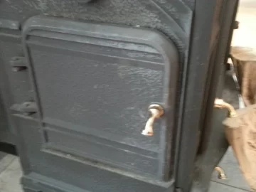

Hey all. I'm very new to the wood burning community, I moved in with my aunt who has a Dutchwest 2462. The gasket on the left side door however is coming loose. I read about a dollar bill test in another thread, my questions are: what is this test? How hard is it to replace these gaskets, and if the gasket is still good what kind of adhesive (if any) should be used to secure it?
This is the primary winter heat source for this home so it's a big concern for me that it runs as well as possible.
Thanks in advance!

The dollar bill test is simply this: Take a dollsr out of your wallet & hold it in such a way that when you close the door of the stove, the bill will be held in place by the gasket. Pull on the bill. If it comes out with very little, or no resistance, then your door gasket is NOT sealing & you are not burning wood efficiently - TOO MUCH AIR.
Replacing the gasket is not difficult, but you must clean ALL of the old adhesive out of the gasket channel. You can use Rutland gasket cement or Hi temp RTV silicone. Search for "gasket replacement" & you should be able to find a detailed step-by-step replacement procedure.

IIRC, it's 5/16 gasket on your door. Take a piece of the worn stuff to your local hearth shop or hardware store & have them match it. If you have a Vermont Castings dealer nearby, then they can tell you for sure what size it is.
Great thanks I tried the dollar bill test and we passed so I think we just need to readhere it to the door.

Just make sure you butt the two ends together well. any gap will allow more air in than you want.
