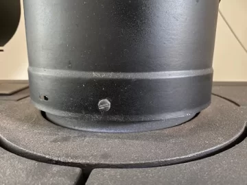

The DVL sits up about 3/8" on our stove collar. Works great. Ours has 3 screws securing it per directions. I marked the DVL with the flue collar hole locations and predrilled clearance holes for the screws. No problem with crushing the pipe. Just stop screwing them in when they make contact. With the risk of puffbacks and earthquakes I always secure the pipe to the stove.

It an Englander Madison. Having different results at the stove collar with different DVL sections. The inner sleeve of the 6" section that i posted about earlier would slide into the stove. None of the other sections will fit, so I'll use an adapter.

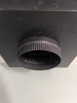

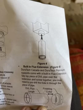

Hey, thank you for the reply. I am using the Duratech 6DT-CS24-2 ceiling support box with 6” DVL, all the same brand and supposedly compatible with each other. From what I’m reading in the online product descriptions for my ceiling box and the installation manual, the flue extension is supposed to negate the need for an adapter and DVL is supposed to slip directly over the flue extension. The DVL does fit over the flue extension, but with about 1/8” of play as the original poster described. This feels suspicious to me and I’m not sure if I should just go with it or if there is in fact an adapter designed for this ceiling box. I’ll attach photos of the flue extension and installation manual.

Thanks for the pictures. I haven't seen this -2 version. This is the variety I've worked with. In this case it's best to follow the rules in the instructions.

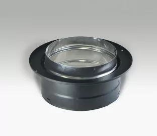

There’s a really nice part for this from duravent. It bolts to the ceiling support box snout and extends down a few inches with what looks like a short section of double wall pipe.
Thanks! And this is compatible with the flue extension on the -2 version of the ceiling support box? Would you mind posting the product number? The photo is a little blurry.

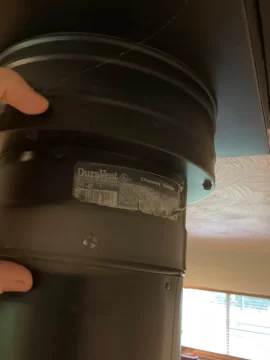

Both of my ceiling support boxes have snouts that look like BG posted above. This fancy piece was an upgraded part from the original cheezy thing that I used originally back in 2007 or so when I first installed this duravent system.
The label got cooked off but it is readily available as a duravent DVL adapter part number 6DVL-ADT.
View attachment 331889 View attachment 331890
What a sucky snout. Looks like something made primarily for single wall.
I think this a new design option from DuraVent. It sure looks single-wall specific.

Hi again, just wanted to write in with an update in case anyone else has the same concern. I screwed the double wall pipe into the support box snout as directed by the manufacturer. The screws made the connection firm, but looking up into the pipe, there were large gaps and it was not a snug fit. However, I have my woodstove up and running and have not experienced any smoke leaks or malfunctions, so it seems to be working just fine. Thanks again for all the help!
