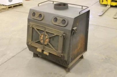

Probably like this one. Made by E.K. Industries in 80 or 81. Went looking for info on them in 2007 and drew a blank. Probably not many of them made. Some thought maybe Energy King but turned out not to be.

Sounds like you have a brick chimney. It would be shaky to use an old brick chimney. It would need to be cleaned and inspected by a pro. Could be dangerous.
But, you could run steel stove pipe down that chimney and you would be in good shape.
I would like to see some pics of this beast, sounds like an oldie but a goodie.
[Hearth.com] E.K. IND wood stove
That is exactly the stove we have in our newly acquired river cabin, I'm looking to find info on the blower. it works on occasion when plugged in , and I believed it needs replacing but can't find any info on it as far as numbers to find something that would work..I did see somebody say keep it oiled.. Not knowing about these wood stoves... How would one oil it as in what to use and where to put it.. Wow that sounds stupid ..Maybe that's all it needs.. The Automatic thermo drat control doesn't function either any ideas on it ?

Best bet for a motor is to take the old one to a place like Grainger and let them come up with a replacement.

Is your Aunt Sarah hooked up & running Trying to get measurements of blower plate & holes under that..
Hey RonB......I have your exact same stove in the basent of our 140 year old brick farmhouse. I had a local sheet metal guy remake an all need w plenum/outer skin and I was back in business. He also calculated output and found me a used blower from a mobile he furnace. We've heated first floor with this unit exclusively. I'm not far away from you 3ither......in La Crosse county
I have this same stove any one find a blower motor for it yet?
My stove is a twin to this one even same rust ..was on it..did you ever come up with a blow or info on it.. Mine seized and it's still winter so I can exactly take her apart at this time of year for any length of time.. looking for the specific on it.. ie; output & hookup measurements. So I can order and have it all there ready to minimize down time

That's Aunt Sarah my Instructions for installing and operation say: Therm-Kon Products, WISCONSIN 1980 Models MM-1, AS-2 & AS-3. BACK COVER states Aunt Sarah is another quality product built for THERM-KON Products by E.K. Industries 207 E Mill Rd. Galesville Wi. 54630 (608)582-2276 which is not in business to my knowledge anymore. unfortunately the diagrams which show the blower Assembly as a optional part only diagrams what screws & the size and how many there are, go where and not any output or other measurements. Sorry hope you guys can stand on your head to read these.. [Hearth.com] E.K. IND wood stove [Hearth.com] E.K. IND wood stove [Hearth.com] E.K. IND wood stove

I have found a blower for the Aunt Sarah that fits up in the exact same mounting plate holes & will work it is the DAYTON 1TDR3 purchased from ZORO
I would think rebuilding the blower could be an option. I can usually rebuild my own motors but with a difficult one I take it to a shop in town that handles that kinda thing and they are always dirt cheap.10-15 bucks.

I have this one too! Would lack of a blower make it unsafe to use or reduce its resale value? It takes up so much room in my basement, and I'm scared to try using it... even more now that i know I'm missing a piece.

The blower kit with heat ex-changer bonnet was a optional upgrade part that increased the BTU output by 20,000 . But was not required.

i have this one in my basement and it is in better shape than this picture. I would like to sell it and want to know how much i should ask?

It depends on the local market but here i tell people to ask about $400 if it is in good shape but expect to only get $300
