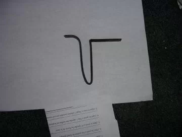

Couldn't figure out how to post a pic, but if you click on my profile and check out my member photo I put up a pic of the cat and clip the way I have it in place.

Can you bend or stretch the clip to hold the converter tighter? Yours is in the same way as mine.

Yeah I did that a little, I just thought there would be a more positive fit.

Test upload of the clip:

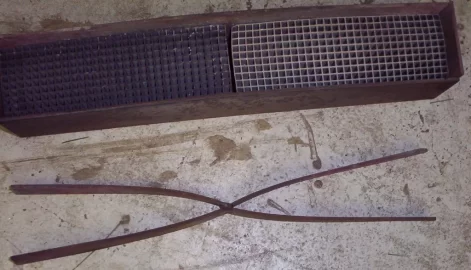

there is a metal 'X' shape that holds the ceramic honeycombs inside the metal housing.
if the 'x' falls out the back, it will spring load the cat assembly and push it OUT of its sleeve.
I will remove mine and take a photo of the X
give me a few minutes.

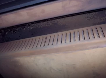

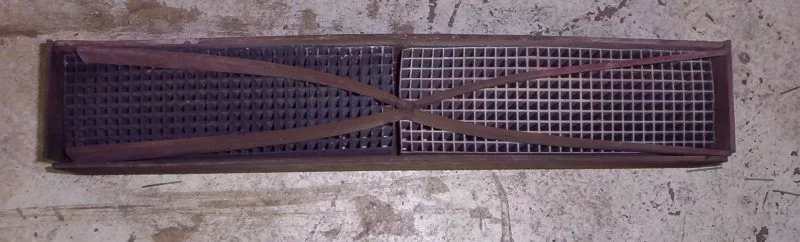

here are pics of the BACK of the combustor unit, see the X, in and OUT of the pics.
I DO NOT have the probe installed in mine, there are two ridges on the BOTTOM of the combustor sleeve, that stop you from pushing the housing too far INSIDE the stove.
if the X falls out the back, it will get sprung between those ridges and the combustor housing.
Mine is missing the bolt/clip assembly to hold from the front, its common for these to be missing, and mine has never fallen out because of this.
check the photos.

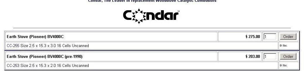

here are the diminsions and prices from condar website
the 2.00 or 3.00 depth difference supposedly happened in 1990 or so, mine has the 2" deep combustors in it, but could use the 3" deep honeycombs IF that X shaped spacer wasnt installed.
