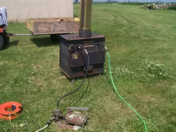

Does anyone know what the flap on the back of my Earth Stove is for and what position it should be in?

Osage nailed it. The damper is probably connected to a knob that preloads a heat sensitive coil. As things warm up, the damper is supposed to react and start to close the intake. They were kinda notorious for sticking as they age.
You can see it in this pic in its wide open position. (I was turning my retired stove into a pool heater).

Our first Earth stove had both a thermostatic air control, and a flapper that shut off all the air. If that is the flapper you are talking about, it should be open while you are burning, closed when not.
