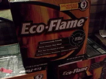

I asked for firewood.
This is what I got.
[Hearth.com] Eco Flame Fire Logs (Kinda Like A Bio Brick? ) ?....
And then was told "the salesman said, they are better than firewood, and clean your chimney".
I'm reading "lower emissions on a firewood grate".
Correct me, if I'm wrong, please.
:mad:
Oh, BTW. I have 3 boxes of these things :)
Give it a try. One or two, not a whole box. I find them hard to light but then they explode so watch closely.
They exploded.
I've got pics, to follow.
If they expand like a magic snake they are not highly compressed. I found that style product poor for long term heat and high on ash production.
That's what I've seen.
I used 1 to get some "not so ready" firewood going.
PE took off like a rocket, once it got going.
Was fun, to say the least.
If that is anything like a dureflame log, do not use in a woodstove! Those are like giant fire starters with wax filler, good for fireplaces and outdoor pits.
We tried eco bricks and found them slow to burn, medium heat, no coals.... better than nothing but not as good as the real deal....
There a a lot of low compression logs and bricks showing up on the market. You can tell them once you know the difference. They're lighter and flakier than the densely compressed products like Homfires, BioBricks or NIELs. Unlike Duraflame, there's no wax binders in these products, so they are ok to burn. They are just big cheap pellets though that release their heat quickly. Burn only a couple at at time and leave lots of expansion room.

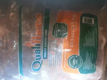

Our local Lowe's has these Niel-like logs, way lighter, and at .89 each okay in a pinch. 10 in a pack, 30lbs, 3lb each, they do coal nicely though.
