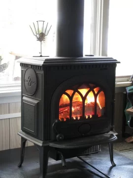

It's true, the fan blows very gently and that was no surprise for me. I've attached a picture of our setup.

@ Burntside guy, we have the exact same stove, except my pipe comes out the back. it looks like yours sits on slate? mine sits on reclaimed chalkboard slate. your setup looks great...i may be slightly biased. thanks for telling me your experience. i think the fans are very cool looking. like a little piece of sculpture. might give it a try.

Thanks. That's a lovely stove and setup,
Burntside guy....awesome setup. I think it looks great.
