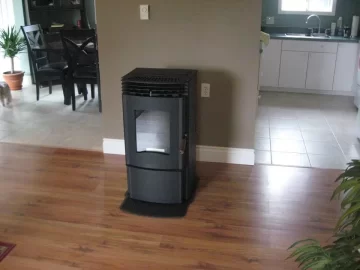

well here she is!! sorry for the poor pic!!
she'll sit there till next week when the install guy does his magic then off to the store to buy me some pellets!! :)

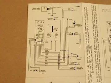

thinkin of a skytech 5301P, just hook the receiver wires up to the two terminals on the stove board that says thermostat?
There should be two 6 inch long, red wires, with female crimps coming out of the control board. You can cut the crimps off and use wire nuts or use a small flat screw driver like those for using on glasses, remove the two red wires and insert the T stat wire.
thanks much hoverfly!!

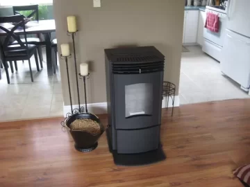

the correct decoritive ceiling piece won't be available til Monday.... he's tryin to find one semi-locally but not holding our breath <>

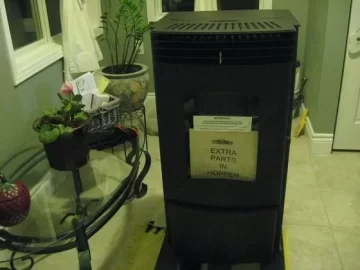

... confirmed install won't be finished until Monday, can't buy one of them supports for twice the price locally!! :(
gonna look for some kind of pellet container we can set beside the stove today...

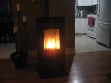

wooohooo!! burnin pellets baby burnin pellets!! :)
  • [Hearth.com] Ecoteck Ravelli Fransesca or Enviro Mini-A?
first night couldnt be happier!!
very quiet!!
lotsa heat with blower on 4, heat on 3 and feed on 2!!
glass a little smokey at the bottom 1/3rd but we're still playin..... what a nice little machine!!
