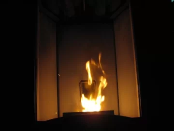

came to the conclusion them Currans musta got wet with the amount of sawdust in the bags and the general look of them.... still got 1 more bag but don't think I'll burn it LOL!!
picked up 15 more Satisfactions and man do they burn nice!!
  • [Hearth.com] Ecoteck Ravelli Fransesca or Enviro Mini-A?
blower on 5
feed on 5
heat on 4
damper out about 3/4"
Satisfaction pellets softwood
nice and warm 76.3 inside and a chilly 16.3 outside!! likin this lil $12 indoor/outdoor Bios wireless thermometer!!

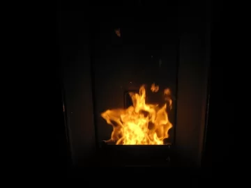

decided to shuterdown for some glass cleaning and snapped this pic!!
really need to find a better way to clean the glass off while the stove's running... maybe a razor blade??
No! No! No! RAZOR blades!! The glass is softer than regular glass, you put a starch in it, you will develop a crack! I forgot how I did it, but I have one in mine and no immediate replacement when it goes. Not Cheap! Just shut it down, let it cool and just use window cleaner and paper towel or a rag. You can also run it for an hour on high to clean it up some what as well. Just watch out pushing ash into the glass air wash vents.

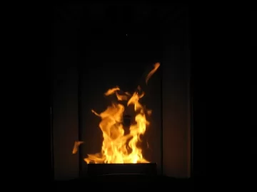

thanks for the tips fellas!!
have NO idea about that 5301P so I'll leave the stove on manual for now... anyways couldn't stand the glass so broke out the windex!! LOL!!
NO idea about the camera either and tryin to experiment catchin the flame!! :ZZZ

NO WINDEX!!!
water or specific stove glass cleaner only.
The glass in your stove actually isn't glass, it's ceramic and doesn't react well to chemicals such as window cleaner (specifically, ammonia will discolor and cloud your ceramic glass).
I know you're excited (we all get that way with a new stove), but make sure you really read up on proper running and maintenance of your stove.
