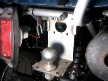

I made it out of a 4" stainless steel ball valve bracket I got from work. Had to do some fabrication but it works.

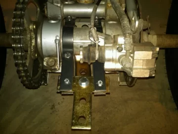

A picture or 2 would be great. You can post them here or PM to me. So far my idea was to use a pair of plumbers pipe clamps around the center axel's hub. Then a piece of kindorf for the ball and pin type hitch. I have gathered a few parts to get started, but haven't been motivated enough to get started. But.....since I put a 2 inch hitch on the splitter I now have something I can pull around with the ATV. I do need to get a small trailer for the ATV.

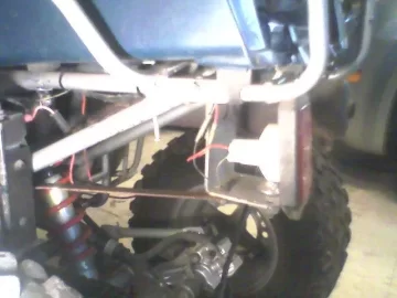

My hitch mounts on the frame under the seat, not on or near the axle. I'll get pic's when I get home.
The part I used is a reinforced L shape that had the correct size hole for the ball. I mounted the other leg of the "L" to the frame under the seat and added a strut to brace it lengthwise to stabilize it during braking and acceleration.

Here are the pic's.
This is a view from behind. Had to turn the tailight to get access. It's not pretty but it works. Other pic is a side view, you can see the thin strap that goes from the bottom of the hitch to near the battery box to act as a brace.

Thanks for the pictures. That's a good hitch for the splitter because you don't have to fold up the leg. I might do the same. I got back to working on the lower axel hitch i have been thinking about for some time. If the pictures works below you can see it's not all done. I have to replace a few bolts and add the ball.

I usually fold the support leg anyway as I have some uneven terrain between the wood pile and the garage. I also like the higher mount point because I don't have to unhitch at the woodpile. It keeps the machine level and at a good work height.
I never considered mounting right to the axle/swingarm. Is this typical for manufacturer supplied ATV hitches? What you have there will work good as well once it is complete.
Ketten,
The OEM ones I have seen mount on the main drive axle. I think it would help with the trailer load pulling and pushing the suspension. I did find a few after market hitches, but couldn't find one for my ATV. So mine is not my idea, just a copy of ones I have seen. Now that the hitch is ready I am looking for a small trailer for hauling wood.
