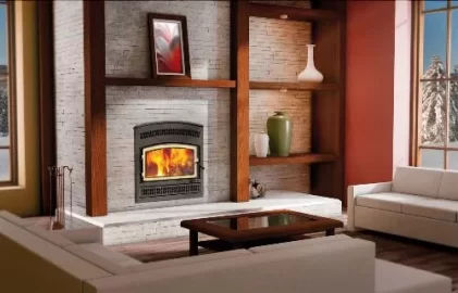

Also if you are still considering a ZC can I suggest the (broken link removed to http://www.valcourtinc.com/product.aspx?CategoId=20&Id=551)? It's a 2.5 cu ft fireplace Washington State approved (below 4.5g/hr). It vents on 6" chimney. It has a large single glass.
The nice thing about this unit is you can install both a gravity kit and heat dump kit- that is you can vent heat in the same room or upstairs without a blower.
Also, You can add a 'heat dump' blower kit thermostatically controlled. This means you can heat a room up to 30 ft away - up, sideway or down. Of course this option requires power to operate. So basically you turn the unit into a small furnace and able to heat various area of your house.
Best of all it's the only High-Efficiency ZC that size that retails at about $3K.
Disclaimer: We make these.
hr). [Hearth.com] Efficient Fireplace Without Blower?

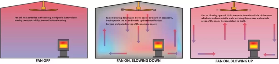

I would err on the side of smaller with a tightly insulated house. The 2.5 cu ft Valcourt would be more than adequate. I don't completely agree with fyrebug in that the stove will still convect somewhat. But hot air being what it is, it will convect right up to the ceiling peak. It's not uncommon to find 110F air at the ceiling and 70F at the floor level with a cathedral ceiling. The reversible ceiling fan is to reduce drafts in the winter by not blowing down on you. It will effectively put the heat where you want it, at the outside walls for draft free warmth and greater comfort on the periphery of the living space.
