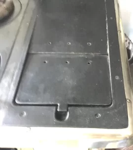

My friends didn’t have any experiencce with that and I was only able to take a very quick look but did take a pic.. Is it that the opening could it be for just ducted not flue heat? In any case if the the Oval was sold without a reservoir there is likely a cover plate. If nothing is available I would think drilling, tapping and screwing on a plate with some gasket cement, if needed, would be much better than welding.
Would removing the screws in the pic around the top frame allow the tank to be lifted out giving better access?

The actual copper water reservoir is bolted to the top plate in several different ways, and the sealed pipe at the bottom for the tap is located in such a way that it appears the entire top part of the assembly has to be removed in one piece. The glitch is that the slanted housing that contains the flap is somehow fastened to that reservoir assembly that appears to be a weld or adhesive. Will the whole works come out as one piece? To be determined.
I do appreciate your observation that a plate drilled, tapped and screwed is a MUCH better alternative to welding. You could be correct that an Oval without a reservoir might have such a (covered) plate installed that way; unless, of course, the manufacturer used a different end panel.
