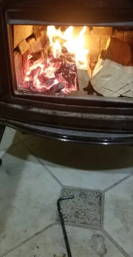

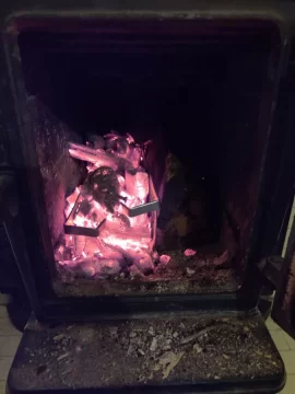

Ok, I gave it a shot today. Used a paint strainer, got the idea for the material from another recent thread. The idea is basically to have the embers act like another log without taking up extra room and without wasting time for the embers to burn down. It worked great. I used the holder as a shovel to get under the embers. This also allowed me to sift out some ash. Scooped embers from the right to the left. This let my ember pile have some form. Able to load logs on the right and fill the stove. Not sure why nobody seems to get the point of this, dunno if I'm doing a poor job explaining or what, but it allowed me to keep the stove at a higher temperature and reload more splits earlier.

It didn’t survive, did it? That one I made the rake out of felt like aluminum.

it survived 1 fire so far, ha. Don't have high hopes for longevity though. This was proof of concept. I need to find something more sturdy for sure. I take it you were where I got the idea from...
You can get expanded metal in heavier steel with different hole sizes. The expanded metal that you often see on landscaper’s trailers is reasonably stout, but, may be too open depending on your expectations for sifting coals/embers.

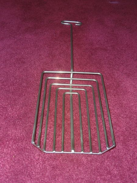

I follow you completely and this is actually a great idea. That way you can essentially make an "ember log", then load up your stove, and put your ember log on top to burn up and light your splits below.
Essentially you need something like this, simply 3x larger (and realistically more holes and less steel) if I'm understanding correctly that way you can load your stove normally and simply move your coals as a single "log" wherever you wish, such as on the top your fresh wood, where they'll quickly burn up rather than continue to accumulate at the bottom of the stove.

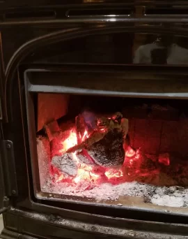

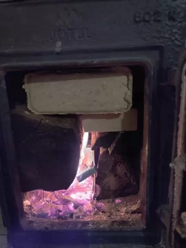

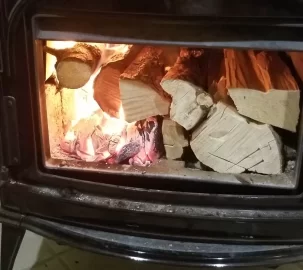

I grabbed some pics of my most recent reload. I do like to run my burns left to right and back again in my stove when it is doing 24/7 duty, so a pile of coals roughly the size and shape of one split is nearly ideal for me. With some experience I can pretty well wrangle my glowing coals around with the L shaped tool that came with my stove.
NB: This was an early reload. We are about to leave for Xmas Eve service, it was now or deal with a cold stove when we get home.
First pic, remaining coals. Second, I got my biggest available split in the bottom right corner, and managed to fit another small piece between the biggun and the coals. Third, I agitated the coals with the L shaped doohickey to knock the ash off them, and then fourth, fill her up and let her rip.
