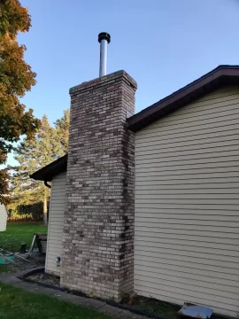

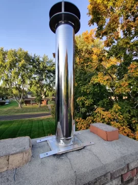

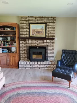

Install
I installed the wood stove myself as follows. A 13ft piece of 6in double insulated flex liner was fed down an exterior masonry chimney. It then passed through an insulated blockoff plate to a 6in tee that I connected to the back of the stove. The flex liner runs almost perfectly straight down from the top of the chimney through the blockoff plate without any large bends etc in it. The Nova 2 sits off the back wall of the fireplace about 16inches placing the majority of the stove out on the hearth. Up top the flex liner is connected to a plate with a 4ft piece of class A pipe running out the top giving me a total height of 17ft. MF Fire recommends a minimum of 15ft for this stove. Please see pictures below of the install. Disclaimer* but after the stove was installed the mantal, bookshelf, etc were removed.

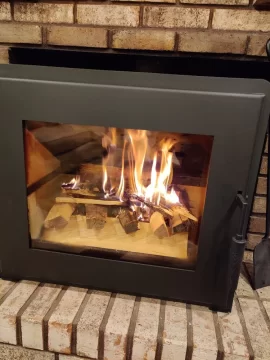

The burn conditions
I have had several fires in the new stove so far. Temps outside have been in the mid 40s during each burn. Fortunately, here in Michigan we have not gotten any freezing weather yet. I am burning seasoned Ash that I cut and split myself.
The Good
-After the first 3 fires the smell of curing paint seems to have vanished. I would recommend you open up some windows when you fire this thing up for the first time
- The veiwing glass does stay relatively clean. If it does happen to fog up, once a strong fire is going again the glass seems to clean itself effectively. That is with the exception of the edges of the glass that do tend to stay slightly fogged after prolonged slow burning. The big window really does make for a great viewing experience.
-The stove is super easy to use. With only one lever to flip I spend very little time messing with the stove. I throw wood in, flip the lever, and walk away.
The Bad
-I have found that this stove must be down to coals before reloading. If I go to open the door when their are any flames I cannot stop smoke from rolling out the front of the stove. I tried all of the tricks recommended on here (opening a window, making sure all fans are off, open bypass, crack door, etc) with no luck. I contacted MF fire in regards to this and they suggested I remove the bypass restrictor plate. In doing so I found the smoke situation improved. I can open the door but if I mess around with any of the burning wood I get smoke out the front again. Of course I do not have anything to compare it to so perhaps a little smoke out the front of a stove is not unusual.

Those are interesting stoves, thanks for the review. I suspect the smoke roll out may be caused by week draft due to relatively warm weather, it may get better as temps get colder.

That is my thought. We will see as temperatures here in Michigan drop. I will be sure to make an update once that happens. I think this stove could benefit from an air control. The simplicity is nice but there is certainly a trade off.

I have learned a thing or two since my initial review. With the cold start I tend to load smaller wood into the stove than what is recommended per MF Fire. I still do a top-down fire which works just fine but my bottom pieces are smaller than the diameter MF Fire recommends. The reason I started doing this was that I was having a hard time getting the bottom pieces to catch and burn well. This would result in smoke going up past the top of the door when doing my first reload. Creating a top down fire with smaller pieces does make it burn faster but creates a great coal bed when I want to load it back up. My cold start will burn for about 3-4 hours. If I do it this way, I do not get any smoke roll out. After my first reload I let it burn down to coals again and can open the door and move coals around and reload without any issue of smoke roll out. I typically reload when my stove top thermometer reads 300-400 degrees. I am not sure how accurate my gauge is but for what it’s worth that is one of my indicators.
If I load the stove up, I will get a 6-7 hour burn and be able to reload the stove without a match or paper. Most of my wood is ash cut at 16-18in so I would expect a full 21-22in piece would help me hit an 8 or 9 hour burn time. That being said, it can get a little toasty with the firebox fully loaded. Not a big deal since I like it warm, but I do think an air control would be a nice touch and could help lengthen the burn time and control the stove temp.
With the above being said the stove is a little picky about draft. If I were to throw a piece of wood in and leave the door open I will get smoke seeping out the top of the door once the wood starts to ignite or if I open the door when there is still wood burning with an open flame. This is my first stove so I am not sure how normal or common this issue is. Ultimately, I have learned how the stove works and have adapted accordingly.

Just an update but I have figured out how to stack wood (ash 16-18in) in the firbox where I can get a 9-10 hour burn that only requires a few pieces of newspaper and some small and medium splits to get it up an running again.

Stove should ship out the 19th to me. My fireplace dimensions look very close to yours. I won’t be able to use the legs and stove will protrude from firebox. I’m planning similar install. Flexible liner wrapped with insulation straight down, through block off plate to a tee into back of stove. It’s a 13 foot interior chimney, Im going up this weekend to repair top of it and will extend the clay flue and bricks up a bit to get closer to the 15. May need to add extension as well. This will be my first wood stove. Currently heating with pellet. Your review and updates are appreciated.

I think it’s going to be my only option. The firebox is smaller in the back than the front so I can only push the stove back so far. It won’t go back enough for the top vent to be in line enough to use. So I’ll have to use the rear vent. I could be wrong but I thought I read somewhere you can’t just 90 into the back of a stove as soot could fall and rest in the 90 causing potential blockage. The tee allows soot to fall and rest past the path of 90.
