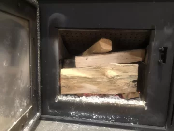

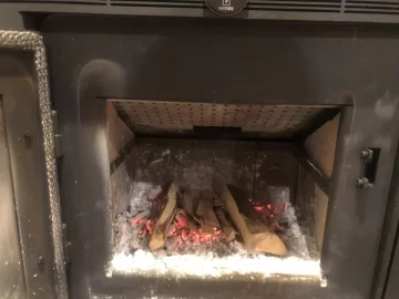

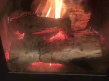

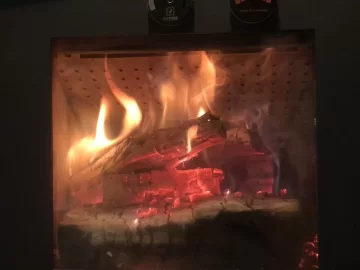

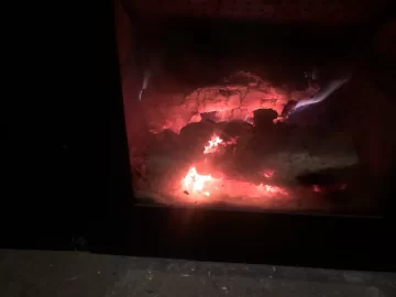

NovaBurner
Feb 22, 2023
6
Connecticut
Here are some shots.
Starting fire:
The load:
At 30 min:
Then at around 1h
At 2h:

That looks to be the issue, The Nova1 capacity is restricted to about 1.6 cu ft due to the sloped back and likely less due to concerns of wood falling and rolling up against the glass. Your results are echoed by the EPA tests which recorded a 2.48hr burn time. The single-rate burn control lets it burn hot and fast for the cleanest burn.
