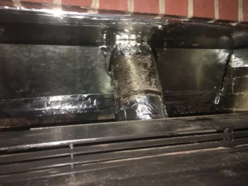

I recently moved into a 1957 brick house with masonry chimney and a fireplace in the basement and upstairs den. I removed gas logs in favor of an insert. I found a local guy selling a BK Princess for $600. It’s about 10 years old and in fair shape. So I picked it up last week and installed a 6” liner with insulation kit. I modified the damper and bent some sheet metal to cover and seal. I also put in a new catalyst. Here’s the problem:
I built my first fire last night and began getting a feel for how it operates. Kept it small and never engaged catalyst. Had the fan on low and turned it up as I was getting ready for bed. Got up and checked on the fire for the last time and in the dark seen a few embers blow out toward the floor. On low it didn’t do it but on high it would continue. So I freaked out turned off the fan and turned damper down on low. Proceeded to stay up half the night paranoid.
I then came home from work today and pulled the insert out and inspected. I was assuming that maybe a pinhole had rusted through around the exhaust (male) connection. I didn’t find anything at all felt around and didn’t notice anything although I’m not certain what I was looking for. So I then assumed that it must be the appliance adapter not being seated correctly. I then really wrenched down on he adapter and retightened the liner. I also wrapped 3 layers of foil tape around the where they join (bad idea, glues melt and stink awful!). Built another fire tonight and the same thing. I looked close and could see a tiny glow under the firebox shroud around the exhaust but maybe an inch away from where it is actually welded into the firebox. Weird thing is that it appears to 1/4” steel in that area. It just doesn’t seem that would rust through.

Yes, metal tape is not appropriate for hot flue liners.
Explain please.
Explain please.

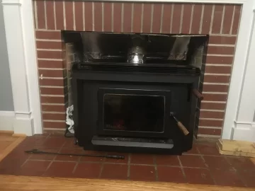

I cut a piece of sheet metal and anchored it into the fireplace and cut a hole for the flue liner to go through. You can kind of see it in the second picture.

Is the flex seated fully into & squarely onto the insert outlet? That is the first thing I would check.
I don’t think it’s perfect. But when I put it in I looked inside the firebox and could see the flex was well into the adapter. I would say within half inch of being perfectly even. The odd thing is that it doesn’t appear to be coming from the connection but I may be wrong. But due to the angle of stove the adapter isn’t perfectly even into the firebox. I connected the adapter to the flex then into firebox. Should I connect adapter then put the flex in?
Ah ok, that is the block-off plate. No problem there.

Were any combustibles used to seal the appliance connector to the stove collar?
No sir. Just connected it to the flex then into the stove. I don’t feel 100% about the seating of the appliance adapter but, it wrenched really hard to push it in. The front is all the way down but the back side is maybe 1/2” from being perfectly down. But, I put the foil tape over the whole connection which I’m assuming would stop any embers from coming through. But again, I’m not certain

I would let the insert go completely cold. Then open the bypass and shine a bright flashlight beam from the interior around the flue collar from the interior. On the exterior, look for any light leaks. This may take darkening the room and an assistant.

Good luck. If it goes back in, look at the interior of the flue collar to make sure there isn't a casting or weld bump in the way of the appliance adapter fully inserting and skip the metal tape.

Start over. First, outer box is not removable. Second, remove bottom brick inside to see if there is a hole. No hole, disconnect flue connector. Clean out stove. Remove door. Lean firebox forward to see if debris comes out...use compressor, but low volume so as to not make home filthy.
Where the flue collar breaks through outer box, there should be a trim ring.

Also get an elbow instead of a straight adapter so everything fits correctly.

BKVP said there should be trim ring. I’m not sure I have this. Can I get a little more info?
