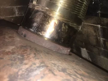

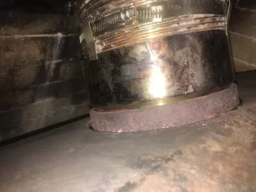

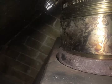

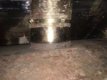

I have attached some pictures of where the adapter is mounted into the firebox. Do you all see any issues?
Thanks for all the input.

Put a screw though that hole in the outlet to assure the liner adapter is held in place to the stove outlet. Adapter looks pretty good to me. Did you try and run the blower while you had it out, to see if it was shorting and throwing any sparks?

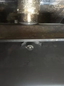

Ok. The cat thermometer when I bought it was shot. So I ordered another on off amazon and it is slightly shorter than the old one. Is this a problem? Also it just sits loose in the hole. Is that right? I have attached a pic.

don't think it should be an issue, I think a few people have switch probes to the condor's

A shorter probe may register lower temps..not sure how the probe is situated with regard to the face of the cat in that stove. Maybe BK guys can enlighten us..
