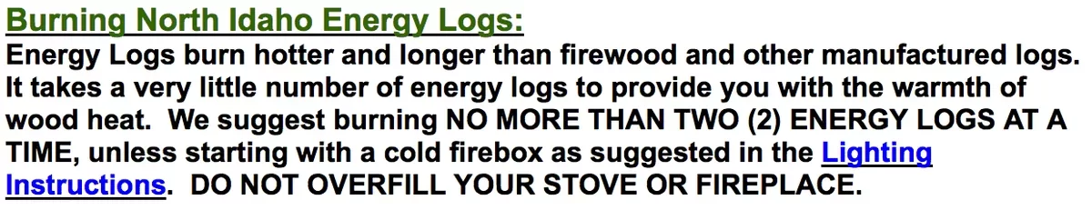

A couple of weeks ago (you may remember the thread) we got our Castine up to 900 degs by putting 3 Northern Idaho Energy Logs on a hot bed of coals. We won't put that much fuel in again, so hopefully we won't have the issue again.

If you are new to the stove the main prevention is common sense. Don't fill the stove up with dry kindling or small sticks. And follow the manufacturer's guidelines if burning compressed fuel. That stuff packs a whallop. Take incremental steps in fuel load size, do your first big loads during the daytime wheh you can monitor the ifre and expect it is going to take a month or so to get the hang of the stove under different burning conditions.

I have a 24' flue, and normally have no problem with stove temps, but this time we put 3 logs on a hot bed of coals. Bad Idea!!! I always thought these stoves were air limited so that a large fuel load would not cause a problem, but that is obviously not the case, especially with compressed logs. Note, that we had already shut down the primary air completely, some where around 600 degs.

The stove is designed to burn up wood gases that would otherwise pollute the air. When the excess of NIELs were put on a hot coal bed they all offgassed at once creating a huge gas bloom which the stove diligently tried to burn up. This is operator error, not a stove design issue.

Yes, I have opened the door to slow down the Castine with a raging fire. It settled down immediately.
I agree that it was operator error, and the stove was doing what it was supposed to do. Other than being hotter than I was comfortable with, looks like no harm done.
The Castine is a robust stove and a good heater. If you put the foot on the pedal and tell it to go, it will. It took me most of the season to learn the ins and outs of the F400. Different wood, different draft (due to outside temps), different fuel size and some tests with compressed wood product made that winter a learning experience.
