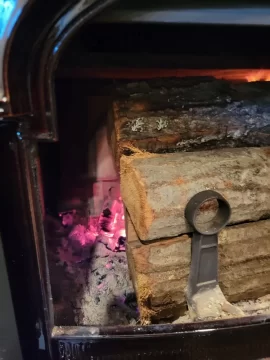

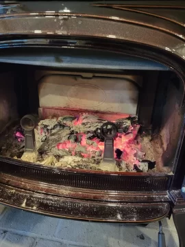

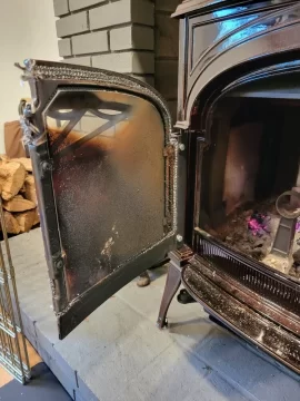

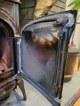

Happy Thanksgiving. Here is what I have done so far this morning. I tossed 3 splits on when I woke up at 4 to let the dog out. Got back from the gym at 8:30 have this bed of coals left cat at 540 and griddle at 400.
I tossed 4 splits on as seen in pic below. Shut damper air is all the way closed. 13 min later my cat is back up to 900 and clowly climbing. So I know it's engaged. My griddle is down to about 300 but to be expected. This should get me solid 4 hours of burn before I load it.
Pics of glass also below. I have not cleaned the glass this year so whatever buildup is there is from late Sept to now. I'll just run a hot fire and let it clean and do it's thing.
