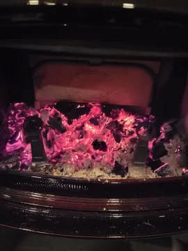

I tightened door latch, which didn’t seem very loose but now tight as will go. Been goin good for probably 7-8 decent size fires. Haven’t had a lot of cold weather lately. Suppose to turn cold tomoro so plan to run it pretty hard consistently n hope for same results. It still goes to between 6-650 every time with damper closed and air all the way down but I’m ok with that if it don’t get any higher. Seems to be a little more under control. Do you get a peak around 600 or more every time you burn a decent load of wood. Like can you keep your stt around 450-500 for an entire burn or no?

Well I guess time to get installers out to check out stove. Sittin here right now with a stove I loaded just over half full. Cat was at 400 when loaded. Went good for bout two hrs. Now three hrs in sttat 700-50, cat got up to 1800. Air all the way down.
That seems real hot for a half load. Was it a hot reload or cold?
