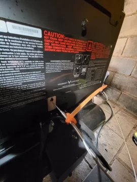

JohnDaileyNH-- could you possibly share any photos of your installed digital cat probe setup? If you're not cooling your stove off, maybe just an exterior photo and a description of the inside? I'm wondering where you situated the probe near the catalyst-- is it on/under/loose/anchored? Touching the catalyst or just in the chamber underneath? It seems like it's working great for you so any details would help.
For anyone else here with these issues-- I followed John's exact instructions in the post I've referenced here, and immediately got a DRASTICALLY better result. I don't even have a cat probe, but I just did the best I could with John's instructions and ballparking it from the STT. Magic. I've been needing to reload every 90-120min, and last night I got 10pm-6am with a hot stove and a warm house in the morning!! (And no bonfire😅). 🎉🎉🎉

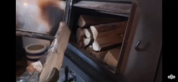

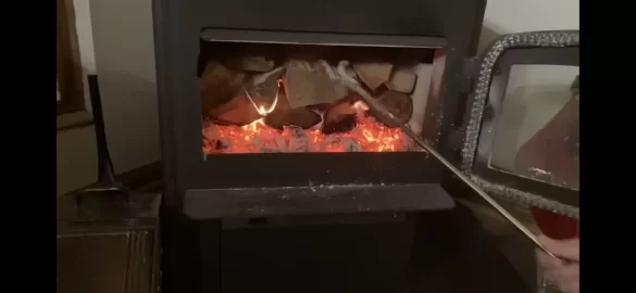

Watching YouTube videos and pulling my hair out, it dawned on me-- by using less logs, I'm leaving soooo much space for extra AIR in there!! So, after double checking my homeowners insurance policy 😏, I got gutsy and filled the thing as tight as I could, so there would be less air. I think it made a huge difference.

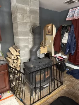

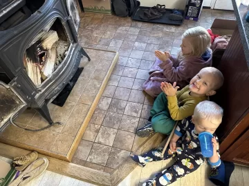

Here's a screenshot of the wood-filled examples from YouTube, and a couple pictures of my stove, just to be friendly.
View attachment 305544 View attachment 305545 View attachment 305546 View attachment 305547
My stove is rubbing so I can't show a pic. But you want the probe inside 2-2 1/2 inches. I put it in the same spot that the factory probe would go and it sits just below the cat. This should be the "exhaust" of the cat. Here are the pics I have. Glad I can be a help. I'm very much learning and figure more info out here the better so the brain trust can work on my issues. I posted the links to the items you need. The probe is 6 inches long so it will stick out the back

look behind your stove where you see the large round hole, and then have someone (or you if you can reach) move the air intake when the stove is completely cold. You should see the thing completely close when you shut it down all the way, and then open a good bit when you open it all the way.

I found a video of someone who just fills her whole stove every time- so she can just "set it and forget it" in the morning, midday, and at bedtime. Without the babysitting.
We're using it as our only heat source, on a windy hilltop, for 6 people, in an 1800sq ft house, with drafty windows, and I've had trouble keeping the house temp to 58° on cold days.
Since I followed your advice last night, it's been at 70°ish for almost 24hrs straight-- just a big load at 5pm, reload at 10pm, reload at 6am, and just now reload at 2pm. 👏🏻👏🏻👏🏻
