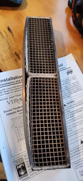

I do have a question, though. With all of the discussions of excessive temps has anyone experienced a warp in the steel frame of their catalyst? I have an Encore 2040. My original cat lasted over 4 years. It was missing a couple of the cell walls inside. I purchased 2 new ones from Condar, and they warped - both of them - right away. I attached a picture of one. I didn't think my stove really got that hot, but maybe it did. The original catalyst never warped. I have the factory Catalyst gauge on the back and after reading all of your comments, I will be replacing it with a digital model so I know exactly where I stand. But back to the issue of the cat - anyone ever have it warp? If I could just wrap it with a little steel belt and cinch it down, it would be like new. Should be like new - one is only 2 days old! On top of it all, it's impossible to find a replacement right now - all are sold out. I see metal is available, so I'll have to go that route unless there are concerns with using that? Thanks again!! I've learned a lot from all of you and want to keep learning more! I quickly realized that this is an art not a science - and I'm no artist, that's for sure! Sneaking in a last question - is it safe to operate with the warped catalyst until I can get a new one?

I have not tried the metal one but will be my next purchase. My cat that I broke before I installed the cat temp probe was warped. Bottom side in the back. I know others have had this happen as well. I believe they are just poorly made and do not stand up to the heat of the cat which I would guess is exceeding 1500 by the looks of that cat after 2 days. I got some from Midwest Hearth and they were in stock, I'd check there.
I don't think there has been a solution to the warping other than keeping cat temps down below roughly 1500. My stove has not been up as high as it used to in a few weeks so I plan to check it this week when it goes cold. I would rotate it when you put it back in. Definitely safe to operate like that. The cat will work even with some hairline cracks in it as well

I reached out to Condar regarding the 2 failures I experienced. They were very nice in their response and explained that they were hesitant to offer the catalyst in the first place, due to the excessive heat experienced with the Encore. This is why their catalyst come with no warranty for the Encore Flexburn. So, I guess I'm with you all in trying to master the temperature control! And here I thought I had it all figured out.

This is good info. I suspect the design is what makes the cat overheat. And there is a fine line to keeping it control and going nuclear
