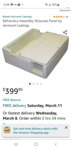

I havent priced it all out but you could do a complete rebuild for under a K... If the stove was free.. do the rebuild this summer.. right now work on getting wood to put in it for next winter.. Good seasoned wood will make your experience better and stove run way better. Your house will be warm.. many on here have cut their heating bills way back.. There are a number of people like myself that have no heating bill at all and the inside of the house is in the 70s.. get wood and set yourself up for success.. Most if not all parts will be on amazon.. your refractory is below
