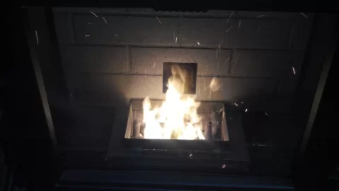

Here is a "Burn" pic.....
  • [Hearth.com] Englander 10-CPM (bought, burn, and install)
Reactions: smoke show
Much preferred over the non burning pictures. Now let it simmer until the stinky is gone.
Yep.... Raining outside. So I removed the Old Englander and installed the CPM. So it has an actual vent and does not get rained on...
Although the burn is not bad. I still feel that it could be better without the by-pass...

Fire looks great Dex. And once you get a pot that sits flat, should be even better. :)
Oh man, that sure is a nice burning stove. Thanks for the high res pic, Dexter.

Talked to Mike. I am gonna call Englander in a bit and they will be sending me a new pot out and also an air deflector for the air wash...

Oh yeah....didn't see that the deflector was missing.
New, flat pot will sure make things burn better, especially with some gasket underneath it....really made a big difference in my unit.
I already installed the gasket... Im sure that helped with the un-even'ness of the pot. Didnt know the deflector was missing until I watched the video and it was explained. I had a few pellets get flown over the air-wash slit on the maiden burn... I didn't think it was right.
The gasket could prob be put on the pot. But because the back edge is small, I put it on the receptacle. Also made sure that the igitor was not affected. Still lines up perfect.

....I had a few pellets get flown over the air-wash slit on the maiden burn... I didn't think it was right.
........Then I will take the exhaust blower out, 2 bottom clean outs, etc and.figure out where the exhaust path goes and where the ash will accumulate. (Seems as if there is 2 plated behind the back wall, that direct the airflow and ash over the 2 clean outs)? Just a guess until I get my Milwaukee Snake Video down the tubes in the back and up the exhaust path from the blower hole (go in from both ends!! )
Even with the air deflector in place, there will be a few pellets that make it over it.....they hit the deflector in the burnpot and bounce up and outward.
