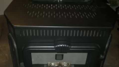

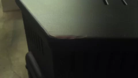

Here are the 2 blemishes. The one before this one (ebay auction) had a weld blemish.

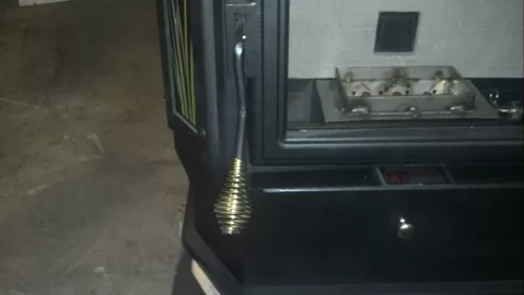

This unit had a slightly crooked handle and grinder damage on the front left corner. From a couple feet away. You would never know. The door handle doesn't bother me, because it looks like it was designed on an angle.
Here is a shot of the handle. A shot from afar of top (look at left front corner) and shot up close of left top corner. [Hearth.com] Englander 10-CPM (bought, burn, and install) [Hearth.com] Englander 10-CPM (bought, burn, and install) [Hearth.com] Englander 10-CPM (bought, burn, and install)

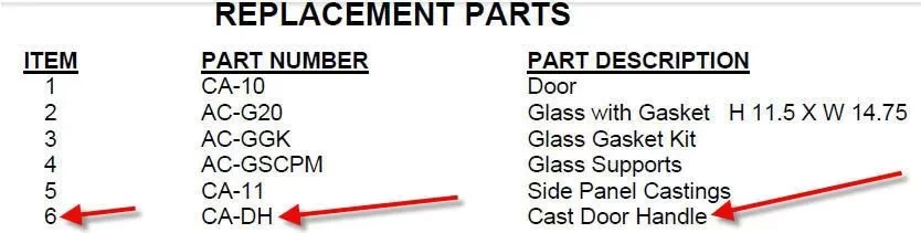

Now all you have to do is order part # CA-DH cast door handle Item # 6 on your owner's manual parts list and your stove will be like brand new!
See pl pic below:

Beacuse I never owned a CPM. It looks like it should be that way. So I am not ordering anything. Its a brand new unit. No need to.

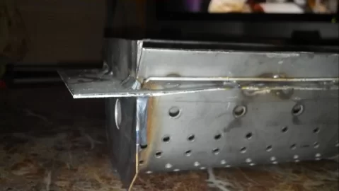

Also either the burn pot or the receptacle it sits in is warped? I can rock the pot back and forth a decent amount? Which leads to another question? It looks like I can add some "Flat" or "Tape" gasket around the top of the receptacle? Has anyone done this to a CPM? I did it to my Fahrenheit and got great results... Yes...I've added some gasket (same as Comb. Blower gasket) ....flame is more lively now. Might want to ask Mike about this too
Well... The pot does seem to be "bent"...
Stil waiting on reply from Mike Holton. But it is bent.....

If it was not welded in so many spots (good thing), I would try and fix it myself? But its got several welds within close proximity and and the stainless is bent.[Hearth.com] Englander 10-CPM (bought, burn, and install)
Dexter, I can tell you that my pot does NOT look like that....it's not right. IMO, it should be replaced.
+1 Mine neither

Sent Mike a PM. Hate to be a PITA already. But this is not right. IMO
And you know you'll be properly taken care of. ;)
Pretty confident that they will. I have yet to see a case, where they didn't help someone.
Imacman and Jrsdws (any other CPM owners too), have you installed any washers inside the door handle? Looks like I can take the bolt out and slide 2 washers on each side of the handle to "tighten" it up. Has some side to side slop in it.

No, haven't had to install any washers on door handle, but might be something I'll try in the future.
